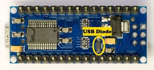

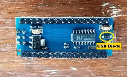

Adding on to abhiarora's answer, if there are no lights at all on the Arduino, and you verify your cable is outputting power, then you may have shorted the device and need to replace the USB port diode. On my Arduino Nano, this diode is directly under the USB-mini port, on the bottom of the board.
Picture of diode: USB diode (original)
I replaced this on my Arduino Nano with the CDBW0520L-HF from Comchip Technology and the Arduino worked perfectly. (Link provided is from www.arrow.com).
And in case you have a Chinese Arduino Nano like me: USB diode (Chinese)

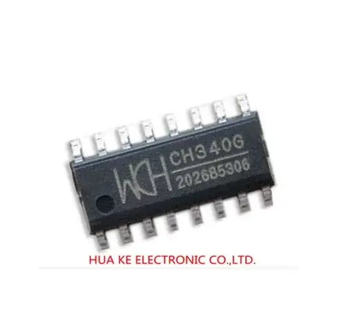

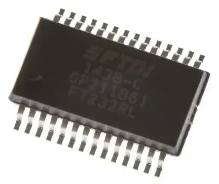

Assuming it is the Arduino UNO (or Nano) you will need to first check if it is a genuine Arduino product or a clone (not that there is anything wrong with using a clone). Check your board for a CHIP near the USB port. See if it reads FTDI or CH340. If it reads CH340, then you have a clone. Not to worry, you can still use it as any normal Arduino, you will just need to install the appropriate drivers for the CH340 chip. A simple search for "CH340 driver" can fetch you the right results for your operating system. enter image description here enter image description here
