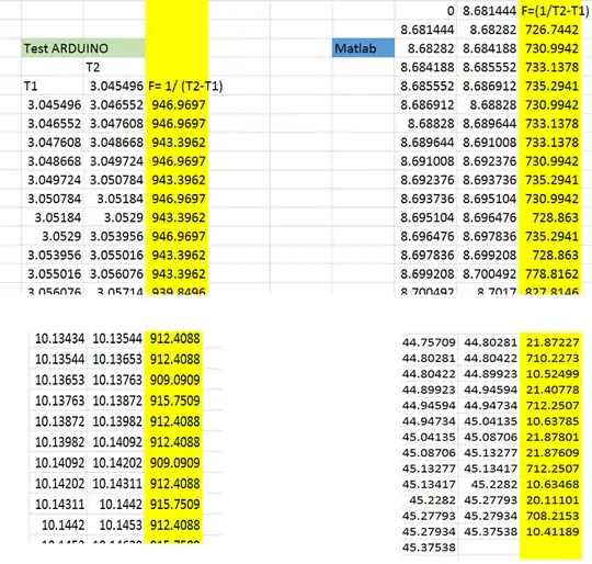

EDIT: Thank you all for responding, As you wanted to see my data, here is a screenshot of the results after I applied Jwpat7's suggestion: enter image description here
The yello shaded column is the frequency calculated, the first and 2nd columns represent T1 and T1 (T2 is just T1 shifted upward for easier calculation). You may notice the Matlab section, this is because I'm trying to plot the data in Matlab and use it to do the digital signal processing after transmission. The plotting will be real time (I'll the data in txt files for later processing). the bottom potion of the figure shows the frequency after a while....as you can see it's decreasing!

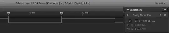

What you have here is a classic case of the measurement of something changing what is measured.
I guessed when I saw your question that the time taken to transmit all that serial data would be longer than 1 ms. If you really were transmitting at 115200 baud then it would take 2.6 ms to send the 30-odd bytes you are sending (30 * 1/11520). Since you are using a Leonardo you get USB speeds which is faster but not infinitely fast.
I could reproduce your figures when I tested.
However if I comment out the two lines that send the time:
//    Serial.print(((double)currentMicros) / 1000000UL, 5 ); // 1 is the number of decimals to print
//    Serial.print('\t');
And also measure separately by toggling pin 13:
  if ((currentMicros - previousMicros) >= INTERVAL_LENGTH_US)
    previousMicros += INTERVAL_LENGTH_US;
    digitalWrite (13, !digitalRead (13));
Then I found that pin 13 toggled at exactly once per millisecond.
(edit) Close enough. See screenshot of logic analyser (0.996 ms):
Logic analyser
That is only 4 µs out - within error range for the processor clock.

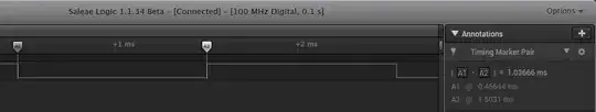

Uncommenting the timing code I found that for a short time I still got 1 ms per iteration, but it then dropped down to around 1.04 ms (ie. 960 Hz). I am guessing that some USB buffer, somewhere, is filling up and not being emptied as fast as you would like.
Here is the screenshot of the code which sends the time (1.0366 ms):
Logic analyser - with debugging code
Notice how simply sending the number of microseconds has increased the time between toggling the pin?
It is helpful to have extra hardware to hand to measure things like this. Using the processor that you are trying to time, to send its own timing information is fraught with problems.
