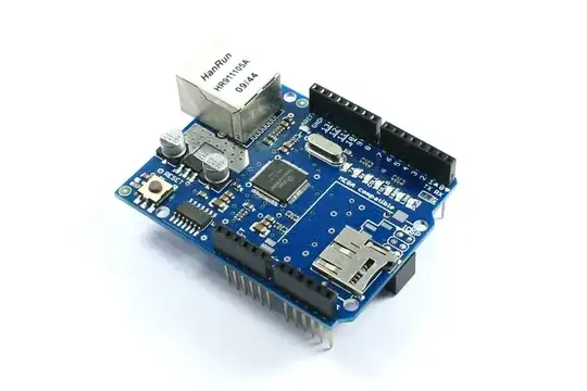

I have an Arduino Uno with an Ethernet Shield based on the Wiznet W5100 chipset : Ethernet Shield
It worked like a charm until I had to move it to another location and plugged it to a Gigabit switch. I had no link, the plug LEDs were off, or just on for a fraction of a second then off again.
I tried several switches, router and Internet boxes (french Freebox), and I ended up with the conclusion that it doesn't work when plugged onto a Gigabit switch. On every 10/100 switches, it works.
BUT

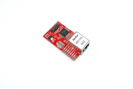

I also have a W5100 small module not designed like the shield : W5100 module
This one is working on Gigabit switches !!!

I tried a second shield (like the first picture), same issue : no connectivity on Gigabit switches.

The fix for this is to solder a 120 Ohm resistor between pins 1-2 and 3-6 of the RJ45 socket (where pin 1 is closest to the left side of the socket when looking at the top of the board. (Credit to keithsw1111 for the fix)
See https://forum.arduino.cc/index.php?topic=372779.0 for full details.
