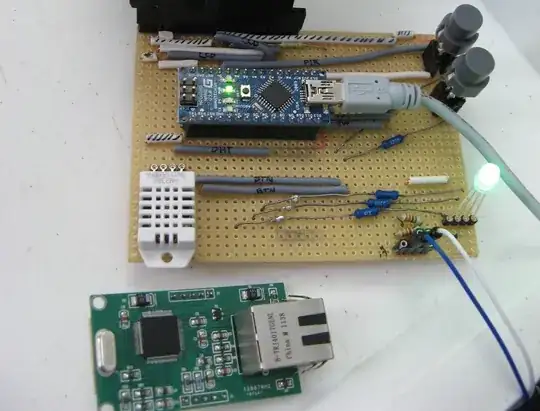

I have an Arduino data collector with a W5100 module (see bottom of picture). Simple fixed IP connection:
 byte mac[] = { 0xDE, 0xAD, 0xBE, 0xEF, 0xFE, 0xED };
 byte ip[] = { 192, 168, 1, 242 };
 Ethernet.begin(mac,ip);
This works with my old routers (Asus WL500, TP-Link MR3420), but fails to connect when plugged in a gigabit switch or my new router (D-Link DWR-116). The connection LED on the new devices does not lit up or blinks slowly, showing repeated connection attempts. So the W5100 fails to make the physical connection.
I made it work by adding my 10-year old Surecom switch to the mix, but wonder what the problem could be. Is there some cable configuration that is used by the W5100 but have been removed from these new network devices? (Not sure if the cable is cross or straight, trying another cable is messy, the whole thing is built in the wall.)
