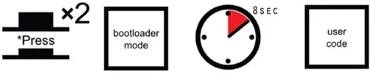

It could be just a question of timing the double resetting of the Micro correctly, in order to enter bootloader mode, see Pro Micro & Fio V3 Hookup Guide - Troubleshooting and FAQ - Reset to Bootloader:
Pro Micro and Fio v3 reset functionality. Press reset twice, quickly to enter bootloader mode
While the Micro is in Bootloader mode, you should see it appear in Device Manager like so:
Pro Micro in bootloader mode - in Device Manager
While it is temporarily in this bootloader mode, you should be able to upload a new sketch.
