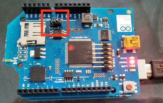

Some shields provide some level of configuration, usually via jumpers, in order to make them usable in more contexts they would usually be.
shield jumper configuration
