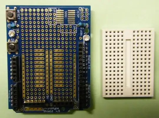

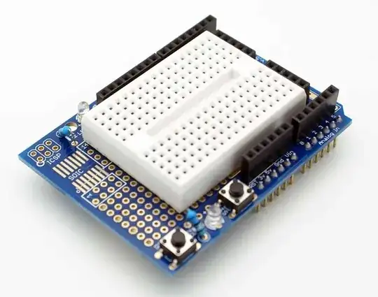

Normally, yes, you may plug other components to your setup after you plug your shield, but it depends on the shield exposing the unused Arduino pins through additional female headers.
Some shields even provide a little protoboard or perfboard to make it convenient for plugging or soldering additional components. Below are some examples:
Example of an Arduino protoboard shield Example of an Arduino perfoboard shield
