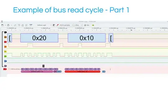

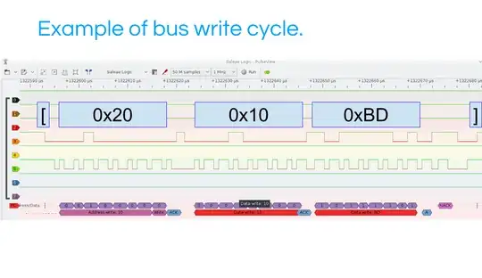

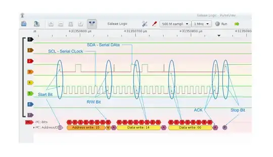

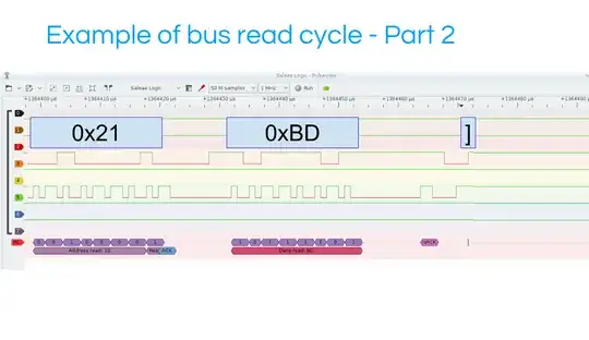

Example of Bus traffic
Example of Bus Traffic Example of Bus Write Cycle Example of Bus Read Cycle Part1 Example of Bus Read Cycle Part2

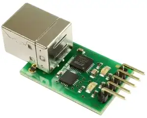

USB to I2C Adapter
usbtoi2c
  • Small footprint.
  • Suitable for permanent installations.
  • No need for special connections on the host: it can be used to interface with a typical PC.
  • Variant available that is also SPI-capable.
  • No console interface, only serial binary protocol.
  • Requires protocol wrapper.
  • Reference: protocol

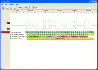

sigrok and pulseview
sigrok(bakend component) logo
sigrok
pulseview (visualizer) example
pulseview

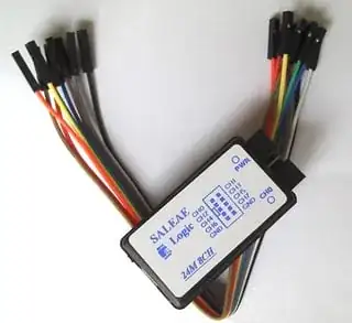

Example of low end logic Analyzer
saleae
  • De-facto standard for PC-driven measurements on linux (but available on other OSes too).
  • Support for vast range of logic analyzers, scopes and meters.
  • Various protocol decoders, including I2C.
  • Useful for visualizing the logical signals and debugging protocol errors.
  • Even very low end, inexpensive HW can provide a whole new dimension to debugging.
  • References: sigrok, pulseview, supported hardware

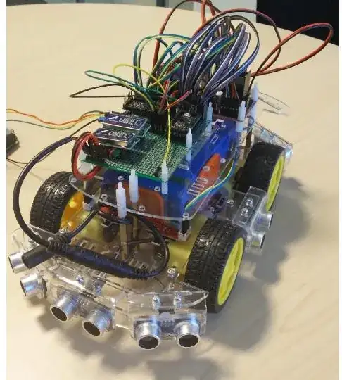

Example: steering a 4WD drone
Prototype built using 2 Arduino Mini Pro. Drone

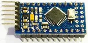

Selecting the Slave: Arduino Mini Pro
MiniPro
  • Enough pins/functions to provide for each wheel:
    • 1 PWM output with independent configuration of the duty-cycle.
    • 1 GPIO for registering odometer input as IRQ.
    • 2 GPIOs for selecting:
      • Forward
      • Reverse
      • Idle
      • Lock
  • I2C HW block for interrupt-driven i2c exchanges.
  • Dedicated pins for SPI-based programming.
  • Small footprint.
  • Low Cost.
  • The board layout of the clone represented in the picture is optimized for mounting on a DIL socket.

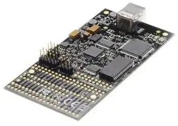

Slave-specific ICD: AVR Dragon
AVR Dragon
