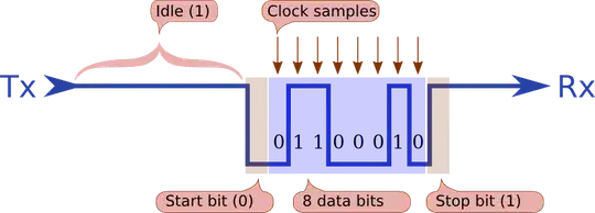

Unlike SPI / USB / I2C serial communications does not have a clock signal. The sampling clock is an agreed-upon sample rate (known as the baud rate). Both sender and receiver must be configured to be using the same rate or the receiver will receive meaningless data (due to the bits not being sampled at the same rate that they were sent).
The transmission is asynchronous which basically means that bytes can be sent at any time, with varying gaps between them. This graphic illustrates a single byte being sent:
Serial comms - sending one byte
The graphic above shows the letter 'F' being transmitted. In ASCII this is 0x46 (in hex) or 0b01000110 (in binary). The least significant (low-order) bit is transmitted first, thus in the above graphic you see the bits arriving in the order: 01100010.
The "idle" time between bytes is transmitted as continuous "1" bits (effectively, the transmit line is held high continuously).
To indicate the start of a byte, the Start Bit is always indicated by pulling the line low as shown on the graphic. Once the receiver sees the start bit, it waits for 1.5 times the sample time, and then samples the data bits. It waits 1.5 times so that it:
  • Skips the start bit
  • Samples half-way through the next bit
If the baud rate is 9600 baud, for example, then the sample rate will be 1/9600 = 0.00010416 seconds (104.16 µs).
Thus, at 9600 baud, after receiving a start bit the receiver waits for 156.25 µs, and then samples every 104.16 µs.
Start bit timing
The purpose of the Stop Bit is to ensure that there definitely is a 1-bit between each byte. Without the stop bit, if a byte ended in a zero, then it would be impossible for the hardware to tell the difference between that and the start bit of the next byte.

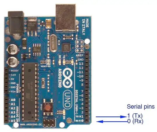

The Arduino Uno has digital pins 0 and 1 available for hardware serial:
Arduino Uno serial pins

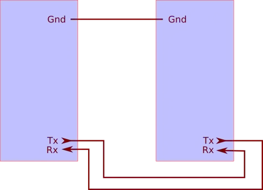

To connect two Arduinos you swap Tx and Rx like this:
Connecting two Arduinos together

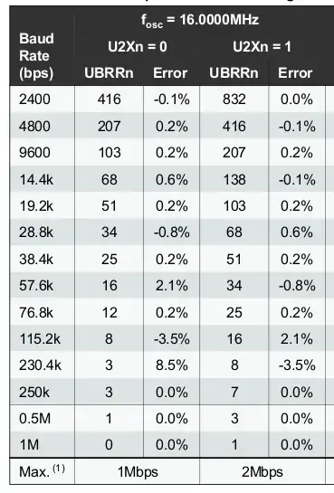

The baud rate on the Atmega is generated by dividing down the system clock, and then counting up to a pre-set number. This table from the datasheet shows the register values, and error percentages, for a 16 MHz clock (such as the one on the Arduino Uno).
Baud rate errors
The U2Xn bit affects the clock rate divisor (0 = divide by 16, 1 = divide by 8). The UBRRn register contains the number the processor counts up to.
So from the table above, we see that we get 9600 baud from a 16 MHz clock as follows:
16000000 / 16 / 104 = 9615
We divide by 104 and not 103 because the counter is zero-relative. Thus the error here is 15 / 9600 = 0.0016 which is close to what the table above says (0.02%).
You will notice that some baud rates have a higher error amount than others.
According to the datasheet the maximum error percentage for 8 data bits is in the range of 1.5% to 2.0% (see the datasheet for more details).

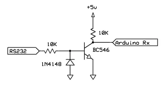

Older serial equipment designed to plug into a PC's serial port probably uses RS232 voltage levels, namely:
  • A "zero" bit is +3 to +15 volts
  • A "one" bit is −3 to −15 volts
Not only is this "inverted" with respect to TTL levels (a "one" is more negative than a "zero"), the Arduino cannot handle negative voltages on its input pins (nor positive ones greater than 5V).
Thus you need an interface circuit for communicating with such devices. For input (to the Arduino) only, a simple transistor, diode, and a couple of resistors will do it:
Inverting buffer
