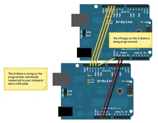

After reading bunch of articles 1, 2, 3, 4, 5, 6 it turned out my bad Chinese Arduino clones does not have bootloader installed on the Atmel microcontroller ship. To solve this problem you need a working Arduino and the clone Arduino we want to fix.
Walk trough who to burn the bootloader: http://www.instructables.com/id/How-to-fix-bad-Chinese-Arduino-clones/
Shortly: Burn the bootloader
Arduino as ISP
  1. You need a working Arduino
  2. Connect the working Arduino with a usb to the computer
  3. Upload Examples->ArduinoISP on working Arduino
  4. Connect the wires from the working Arduino to the clone as follows:
    • Pin 10 goes to reset pin
    • Pin 11 -> 11, 12 -> 12, 13 -> 13
    • 5v to 5v and ground to ground
  5. Go to Tools->Board and select the chinese board that is not working. in my case it's an Arduino Uno.
  6. Go to Tools->Programmer and select Arduino as ISP.
  7. Go to Tools again and select "Burn Bootloader".
  8. Your clone should work just fine now, but don't forget to restore Programmer (set back to ArduinoISP or AVRISP).
My clone board does not had integrated LED on 13 pin :) you need to connect it for Blinking test.
