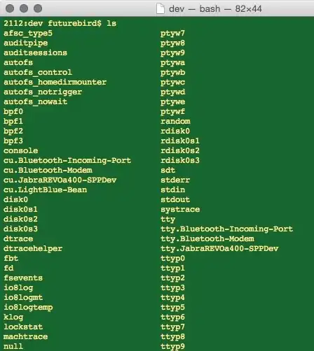

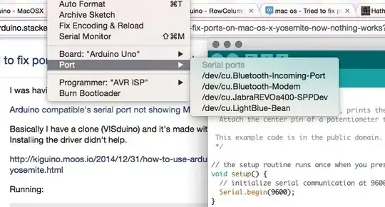

Well.... now nothing works. Before doing this I could use:
  • Adafruit metro
  • An uno clone
  • My genuine uno
  • lightBlue Bean
  • adafruit trinket and trinket pro
  • adafruit trinket pro via USB
  • digikey
I've reinstalled the drivers for these but NOTHING is working now. They were all working before. It just says Arduino Uno on COM1, or digikey on COM1 etc.
And of course my clone (vis duino) isn't working either.
How can I fix this?
The com ports just are not there.

I solved this issue by deleting all of the Arduino files and the Arduino app. I put my sketched folder aside but deleted all libraries.
Restarted the computer.
Installed Arduino fresh.
Installed the drivers.
Ran the command.
Then it worked.
