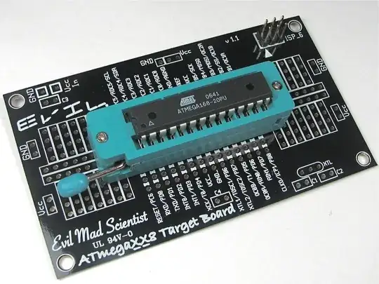

You could get an ATmegaXX8 target board from Evil Mad Scientist. That has (or can have) a ZIF socket so you can easily remove the chip without bending its legs.
AtmegaXX8 target board
That's around $US 3 for the board, $2 for the ZIF socket, $1 for the crystal, 45 cents for the ICSP header.
You can put an Atmega328P into the socket (same chip as on the Uno). Note that some soldering is required. You would need to solder on the ZIF socket, the ISP header, and make up an FTDI header if you wanted to easily program it from the IDE.
You would also need (or it would be helpful to have) a 16 MHz crystal along with 2 x 18 pF capacitors. They have them for sale at that site.
You would also need a 10 k pull-up resistor for Reset, a couple of 0.1 µF decoupling capacitors, and another 0.1 µF capacitor for handling reset via the FTDI interface - if you use it.

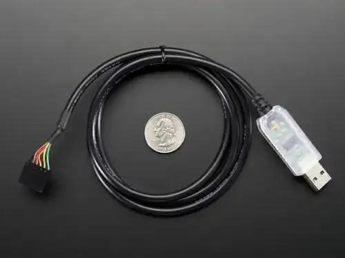

If you want to program serially (and do serial debugging) you need some sort of USB interface, such as an FTDI cable or board.
Example FTDI Serial TTL-232 USB Cable.
FTDI cable
That is around $US 18. (Of course, you only need to buy the cable once, so this is a one-time cost).
You would need to solder in 6 header pins in a line to plug that into (on the prototyping area) and then run appropriate wires to Tx/Rx/Gnd/5V and Reset via the 0.1 µF capacitor I mentioned.
