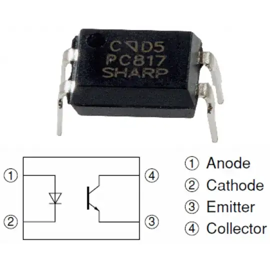

Some good results you can get with optocouplers. PC817 photo
It's electrically disconnects one part of your circuit from another.

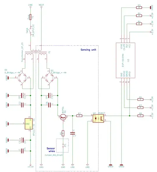

For example, here is my IoT-ish device, which is detects water leaks in my bathroom: Scheme
I use the transformer (T1), which have two separate output windings, so, that windings does not connected electrically, only magnetically. The block in border "Sensing unit" doesn't have any wires with other scheme - only magnetic field, which is gives it power, and infrared light in the optocoupler (u2, PC817), which informs ESP01 about leak presence.
How does it work? Very simple! When the water shorts JP1 (long naked wires on the floor), Q1 opens and lights-up the IR diode in PC817. Light from this diode opens another transistor - and pulls the RxD PIN of ESP01 down.
Small sketch, written on Arduino for ESP8266 periodically sends pin state by HTTPS on my web server, where monitor software, Nagios, checks the information age and the pin state, and send to me notifications, when something goes wrong.
