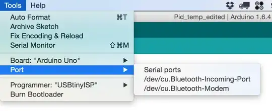

Under my Tools > Port menu.. I can see these options: enter image description here clicking the Serial Ports option doesn't do anything.
