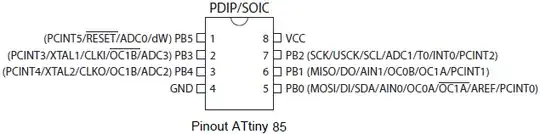

jfpoilpret provided great answer for parsing serial command on Arduino. However Attiny85 doesn't have bidirectional serial - SoftwareSerial has to be used. This is how you port same code for Attiny85
#include <SoftwareSerial.h>
// Calculate based on max input size expected for one command
#define INPUT_SIZE 30
// Initialize SoftwareSerial
SoftwareSerial mySerial(3, 4); // RX=PB3, TX=PB4
// Parameter for receiving Serial command (add 1 for final 0)
char input[INPUT_SIZE + 1];
  mySerial.begin(9600);
  // We need this counter to simulate Serial.readBytes which SoftwareSerial lacks
  int key = 0;
  // Start receiving command from Serial
  while (mySerial.available()) {
    delay(3);  // Delay to allow buffer to fill, code gets unstable on Attiny85 without this for some reason
    // Don't read more characters than defined
    if (key < INPUT_SIZE && mySerial.available()) {
      input[key] = mySerial.read();
      key += 1;
  if (key > 0) {
    // Add the final 0 to end the C string
    input[key] = 0;
    // Read each command pair
    char* command = strtok(input, "&");
    while (command != 0)
      // Split the command in two values
      char* separator = strchr(command, ':');
      if (separator != 0)
        // Actually split the string in 2: replace ':' with 0
        *separator = 0;
        int servoId = atoi(command);
        ++separator;
        int position = atoi(separator);
      // Find the next command in input string
      command = strtok(0, "&");
Attiny85 schematics for pin numbers enter image description here
Sketch compiles into:
Sketch uses 2244 bytes (27%) of program storage space. Maximum is 8192 bytes.
Global variables use 161 bytes (31%) of dynamic memory, leaving 351 bytes for local variables. Maximum is 512 bytes.
So there is plenty of space and memory for the rest of code
