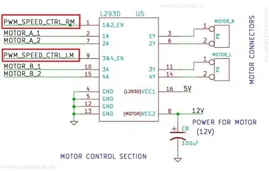

I would say it would be the best way to use a H-bridge motor driver such as L293N. With it you can simply drive a DC motor both ways and even control it's speed.
Make the connection as shown on picture below, but connect wires of both motors to the same motor and PWM_SPEED_CTRL are channels connected to the Arduino. Don't forget to add relays between pins: 3-1, 6-2 and 11-1, 14-2, which would determine the turning direction.
If you don't understand certain thing, just ask and I'll try to reply ASAP.
