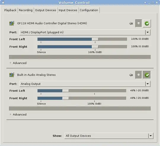

Open the Volume Control (pavucontrol in the shell), go to the Output Devices tab and push the "Default" button in front of your Bluetooth audio device:
