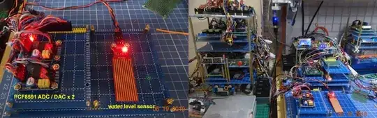

project towers
I usually use separate boards for ADCs and sensors, and usually one ADC or one sensor for one board, sometimes 4 ADC and 6 sensors on one board.
I think you begin to see the complexity of structuring the protoboards. All my big and small proto boards are stackable, and I usually stack up to 4 or 5 board to make a tower, and some or my projects consists of 6 or 8 towers each up to 30 cm high, with power and data cables all mingled.

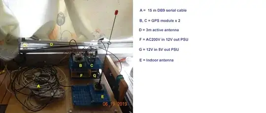

Update 2019jun19hkt1512
This GPS sensor modules have 15 meters DB9 serial cable, 3 metr active annetna, therefore not practical to secure to a breadboard. :)
gps module setup. / to continue, ...

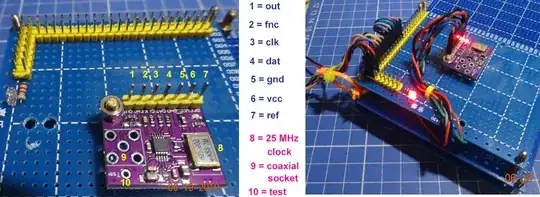

Update 2019jun19hkt1734
Though I don't have a big, universal piece of hardware, as the OP says for all things, but I do have smaller pieces of smaller pieces of hardware, in the form of protoboards, each for a small group of ADC/senor/actuator below is an example, it is a sort of semi hot plugable, reusable, protoboard for generic SPI/I2C/UART devices. The routing cables has buffer/temporary/easily replacable middleman type short cables, which when worn out after a big number of plugging/unplugging, can be easily replaced, without any necessity to replace the permanent long cables. The temporary cables also are cable tied to the brass spacing post to do strain relief. These things are what I have been doing these years, and should satisfy part of the OP's requirements! :)
ad8933 protoboard_2019jun1901
