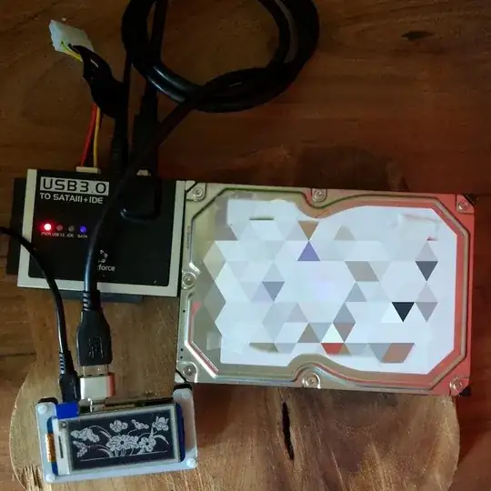

I'm trying to connect a 3.5" drive to a Pi Zero. However, the drive is not detected by the Pi:
pi@lolcat:~ $ dmesg | grep sd

pi@lolcat:~ $ lsusb
pi@lolcat:~ $
I am using a simple OTG adapter which has worked fine with USB sticks. The drive is connected and powered via a standalone SATA to USB3 adapter (i.e. no hub involved). A photo of the setup follows.
Pi Zero
Any suggestions on what could be wrong with this setup?

m000
  • 483
The culprit turned out to be the mini OTG adapter: It is cute, but it doesn't work with the hard drive. Switching to a regular OTG cable made the drive appear.
Following is a diff of the boot messages when using the mini OTG adapter and the OTG cable. The message timestamps have been removed to produce a clean diff. Someone more familiar with Pi hardware can perhaps explain what went wrong from this.
--- connected-miniotg.p.txt 2019-06-12 21:43:36.767350223 +0200
+++ connected-cableotg.p.txt    2019-06-12 21:43:24.967383295 +0200
@@ -178,24 +178,32 @@
 mmc-bcm2835 20300000.mmc: DMA channel allocated
 sdhost: log_buf @ db513000 (5b513000)
 random: fast init done
+Indeed it is in host mode hprt0 = 00021501
 mmc1: queuing unknown CIS tuple 0x80 (2 bytes)
 mmc1: queuing unknown CIS tuple 0x80 (3 bytes)
-mmc1: queuing unknown CIS tuple 0x80 (3 bytes)
-mmc1: queuing unknown CIS tuple 0x80 (7 bytes)
 mmc0: sdhost-bcm2835 loaded - DMA enabled (>1)
 of_cfs_init
 of_cfs_init: OK
+mmc1: queuing unknown CIS tuple 0x80 (3 bytes)
 Waiting for root device PARTUUID=9596604c-02...
-mmc1: new high speed SDIO card at address 0001
+mmc1: queuing unknown CIS tuple 0x80 (7 bytes)
+usb 1-1: new high-speed USB device number 2 using dwc_otg
+Indeed it is in host mode hprt0 = 00001101
 mmc0: host does not support reading read-only switch, assuming write-enable
 mmc0: new high speed SDHC card at address aaaa
 mmcblk0: mmc0:aaaa SC16G 14.8 GiB
  mmcblk0: p1 p2
+mmc1: new high speed SDIO card at address 0001
 EXT4-fs (mmcblk0p2): mounted filesystem with ordered data mode. Opts: (null)
 VFS: Mounted root (ext4 filesystem) readonly on device 179:2.
 devtmpfs: mounted
 Freeing unused kernel memory: 440K
 This architecture does not have kernel memory protection.
+usb 1-1: New USB device found, idVendor=1f75, idProduct=0611
+usb 1-1: New USB device strings: Mfr=4, Product=5, SerialNumber=6
+usb 1-1: SerialNumber: 20150327
+usb-storage 1-1:1.0: USB Mass Storage device detected
+scsi host0: usb-storage 1-1:1.0
 systemd[1]: System time before build time, advancing clock.
 NET: Registered protocol family 10
 Segment Routing with IPv6
@@ -205,26 +213,37 @@
 systemd[1]: Detected architecture arm.
 systemd[1]: Set hostname to <lolcat>.
 random: systemd: uninitialized urandom read (16 bytes read)
+scsi host0: scsi scan: INQUIRY result too short (5), using 36
+scsi 0:0:0:0: Direct-Access     ST315005 41AS                  PQ: 0 ANSI: 0
+sd 0:0:0:0:
+sd 0:0:0:0:
+sd 0:0:0:0:
+sd 0:0:0:0:
+sd 0:0:0:0:
 random: systemd-sysv-ge: uninitialized urandom read (16 bytes read)
-systemd[1]: Created slice User and Session Slice.
-systemd[1]: Listening on Journal Socket.
+ sda: sda1 sda2
+sd 0:0:0:0:
 systemd[1]: Listening on Syslog Socket.
+systemd[1]: Listening on udev Kernel Socket.
 systemd[1]: Listening on Journal Socket (/dev/log).
+systemd[1]: Listening on udev Control Socket.
 systemd[1]: Created slice System Slice.
 systemd[1]: Mounting Debug File System...
-systemd[1]: Reached target Slices.
+systemd[1]: Reached target Swap.
+random: crng init done
+random: 7 urandom warning(s) missed due to ratelimiting
 i2c /dev entries driver
 EXT4-fs (mmcblk0p2): re-mounted. Opts: (null)
-systemd-journald[76]: Received request to flush runtime journal from PID 1
+systemd-journald[66]: Received request to flush runtime journal from PID 1
 snd_bcm2835: module is from the staging directory, the quality is unknown, you have been warned.
 bcm2835_alsa bcm2835_alsa: card created with 8 channels
 brcmfmac: F1 signature read @0x18000000=0x1541a9a6
 brcmfmac: brcmf_fw_map_chip_to_name: using brcm/brcmfmac43430-sdio.bin for chip 0x00a9a6(43430) rev 0x000001
 usbcore: registered new interface driver brcmfmac
+usbcore: registered new interface driver uas
 brcmfmac: brcmf_c_preinit_dcmds: Firmware version = wl0: Oct 23 2017 03:55:53 version 7.45.98.38 (r674442 CY) FWID 01-e58d219f
 brcmfmac: brcmf_c_preinit_dcmds: CLM version = API: 12.2 Data: 7.11.15 Compiler: 1.24.2 ClmImport: 1.24.1 Creation: 2014-05-26 10:53:55 Inc Data: 9.10.39 Inc Compiler: 1.29.4 Inc ClmImport: 1.36.3 Creation: 2017-10-23 03:47:14
-random: crng init done
-random: 7 urandom warning(s) missed due to ratelimiting
+sd 0:0:0:0: Attached scsi generic sg0 type 0
 uart-pl011 20201000.serial: no DMA platform data
 Adding 102396k swap on /var/swap.  Priority:-2 extents:1 across:102396k SSFS
 Bluetooth: Core ver 2.22
m000
