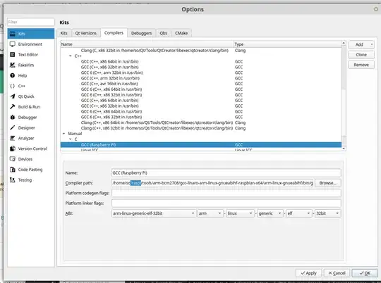

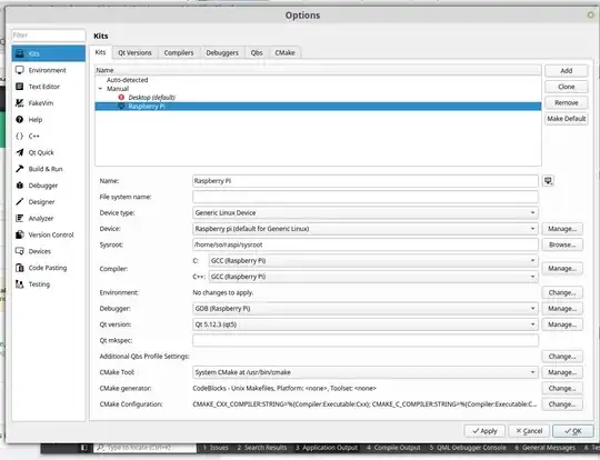

My raspy kit setting is shown here: enter image description here
AND My qt Raspberry Compiler setting is shown Below: enter image description here
