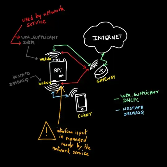

EM0
A common mistake is the conflict between hostapd and the raspbian networking service that uses the same interface and therefore two different modes which causes the access point to stop. Ensure the interface is not used by the network service for get an ip address in '/etc/network/interfaces'and remove any dhcp configuration related to the AP interface.

The "solution" you have adopted uses an illegitimate mix of 2 networking systems. It may "work", but will not be robust. It would work, if you disable dhcpcd, otherwise you will have 2 systems trying to configure the networks, with unpredictable results.
The "correct" way of setting up one interface as an Access Point is to tell dhcpcd NOT to configure it. See Prevent dhcpcd from configuring an interface in How to set up networking/WiFi
Specifically add denyinterfaces wlan1 to the end of the /etc/dhcpcd.conf file (but above any other added interface lines). This allows dhcpcd to operate normally on wlan0.
See the Foundation tutorial Access Point
PS Any time you use multiple interfaces you should use Predictable Network Interface Names; The on-board WiFi will usually win the race between configuring the 2, but it is better to explicitly manage this, to avoid any race condition.
