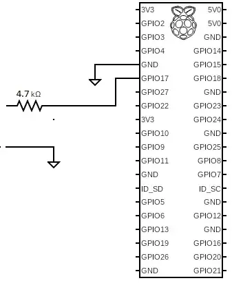

  3. add a series resistor of 4.7k that limits current to ~0.9mA, much less than the 16mA safely supported by each GPIO pin. With this resistor the switch from logical high to logical low will happen with when the input tension falls to ~2-3V (assuming internal pull down value 40-100k). In case you want the switch happens at an higher tension you should increase the value of the series resistor, but higher resistor means lower current and more sensitivity to noise. interface between pushbutton and Raspberry
Resistor in series to GPIO
