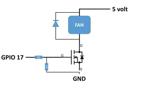

There are many guides on how to set up a 5V fan for a Raspberry Pi and control its speed with PWM. Usually, this includes using a
  1. a transistor
  2. a resistor between the PWM pin and the transistor gate
  3. a resistor between the PWM pin and the ground pin
  4. a diode in parallel to the fan
For example here is a diagram that I took from the Sensoriot blog: enter image description here
I have a Noctua 5V PWM fan that has a built-in PWM speed control and a diode.
Thus I suppose, I don't need another diode, and the transistor is already in the fan as well. However, I'm confused about whether I should still add resistors, or they are already somehow pre-installed in the fan as a part of PWM support?

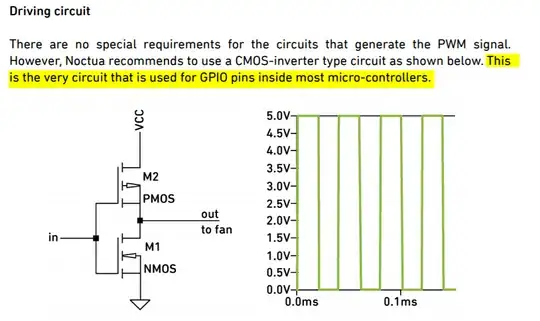

The manufacturer of your fan provides a global "PWM" Specification for their products. They call it a "white paper" which is simply that they do not guarantee anything in this document, but it is as good as it gets. If you can find it they reference the formal Intel Spec : “4-Wire Pulse Width Modulation (PWM) Controlled Fans”, Intel Corporation September 2005, revision 1.3
https://noctua.at/media/wysiwyg/Noctua_PWM_specifications_white_paper.pdf
Page 6 of the whitesheet we see
  1. Maximum voltage for logic low: VIL=0,8V
  2. Absolute maximum current sourced: Imax=5mA (short circuit current)
  3. Absolute maximum voltage level: VMax=5,25V (open circuit voltage)
  4. External pull-up is not necessary as the signal is pulled up to 3,3V/5V inside the fan.
They even provide a handy reference
In this case, this is a simple logic level PWM signal, with no unusual requirements and without the gate capacitance issue requiring the series resistor. They also have an onboard pullup so no floating pin concerns. Check check!

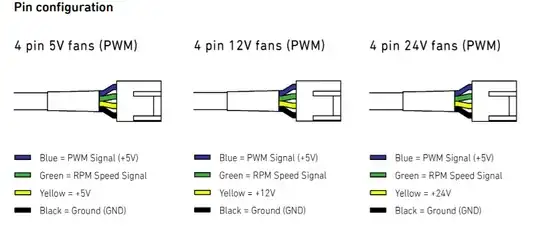

Pinout
Power supply is provided on different pin from PWM
 B - PWM
 G - Feedback
 Y - V+
 B - GND
Use case
The built in PWM means that the circuit in your question is integrated. However, the details of this are hidden from you, so we must rely on the spec and not guess what is the internal driver
Specification
Page 6 of the white sheet

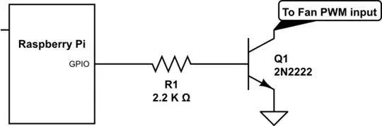

I think the IRLZ44N transistor is extreme overkill for the fan you're using. The blog you've quoted is lacking in important hardware details (I've not read his code), but it appears he's just ON-OFF banging a 2-wire fan with a GPIO pin driving a MOSFET. I'd counsel some caution in following the approach outlined here, but I may be a bit biased by people who blog about "pimping" a Raspberry Pi, and conjuring "a little bit of magic". Magic really isn't required for your project.
If I understand what you're trying to do with the fan you've selected, you won't need a MOSFET capable of sinking 4 Amps or more (depending on VDS). According to the fan mfr's website, you'll drive the Blue = PWM Signal wire of their fan with a 5v, 8mA open-drain/open-collector output. The specifications for this interface are spelled out in this document.
Wrt your question on the resistors: I'd answer "No, not needed - not even wanted." You're not building an arc-welder, so I'd suggest that you use a low-power npn bipolar transistor (e.g. 2N2222) to generate the PWM signal to drive your fan. It will sink 600 mA of current (75x what the spec requires), and requires only (approx) 1 mA of base drive (so your GPIO is not stressed at all). You will need a resistor between your GPIO pin and the base terminal of the 2N2222; use a 1.5Kohm - 3.0Kohm resistor.
schematic
Just one other point:
Wrt the diode, the mfr. calls their diode a reverse-polarity protection diode. It serves an entirely different purpose than the diode in the blog you referenced. But you won't need a suppression diode.
