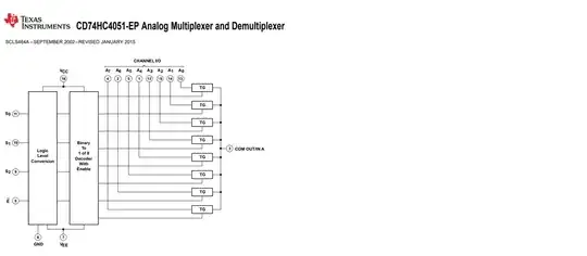

  3. You can use any analog multiplexor/demultiplexor such as HC4351.

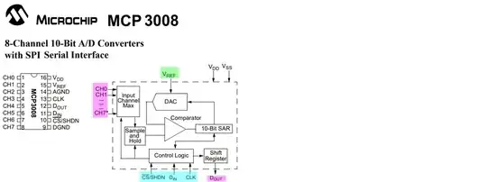

MCP3008 SPI 8 Channel 10 bit ADC
CD74HC4051-EP Analog Multiplexer and Demultiplexer [Supports Defense and Aerospace Applications] - Texas Instruments

Appendix A - Analog Mux/Demux Block Diagram
analog mux block diagram
Appendix B- 8 Channel ADC Block Diagram
mcp3008 block diagram

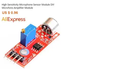

Appendix C - Mini Microphone and Power Amplifier
mike and amp
