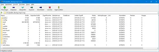

I made an IMG-File of my LibreELEC and now i want to edit it on my Windows machine.
I need to make changes in the /etc-Folder and I can't do that live on the system since LibreELEC is read-only FS.
So I opened the img-File with 7-zip and there is no /etc-Folder. It seems as this is the /storage-Folder!
7zip
Any suggestions where I can find and edit the /etc-Folder?
