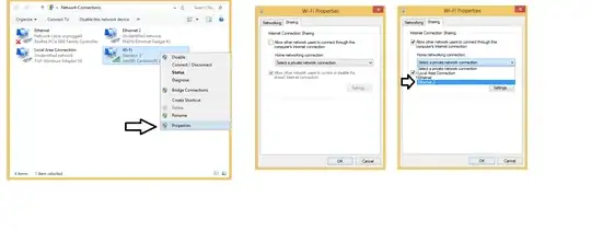

SO i need the similar instruction for enabling sharing my internet via USB enp0s20f0u1 device (PI Zero) in Linux. for example in windows we need to :
In the WiFi Properties window, click on the “Sharing” tab : similar to this photo:
WiFi internet sharing
So in Linux version what is the similar instruction to doing this?

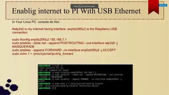

Based of this PowerPoint slide, then next step is doing this commands in Linux like this:
sudo ifconfig enp0s20f0u2 192.168.7.1
sudo sysctl net.ipv4.ip_forward=1
sudo iptables --table nat --append POSTROUTING --out-interface wlp2s0 -j MASQUERADE
sudo iptables --append FORWARD --in-interface enp0s20f0u2 -j ACCEP
The enp0s20f0u2 is the USB port of Raspberry Pi Zero, and 192.168.7.1 is the IP Address of the USB by this setting:

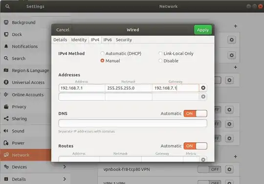

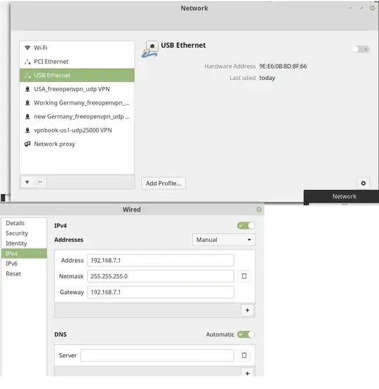

unplug pi and then connect it to usb again .it'll probably be set up for DHCP by default so change it to Configure IP4 Manually:
For the IP address pick 192.168.7.1 (note that this is not the same
as the Pi Zero's address!) For the subnet mask, use 255.255.255.0
(same as Pi) For the router/gateway use 192.168.7.1 (same as Pi)
If you didn't use our suggested netconfig above on the Pi, you may have to adjust this one to Linux similar to this: enter image description here
and then you could run sudo ssh pi@192.168.7.2 to connect to that, second part is could be done easier and you must configure your mode, to share internet with this IP (192.168.7.2) and i will write tomorrow.
