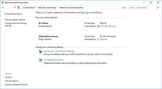

  2. Connected My PC with internet via WiFi and modified the Wi-Fi properties as shown.

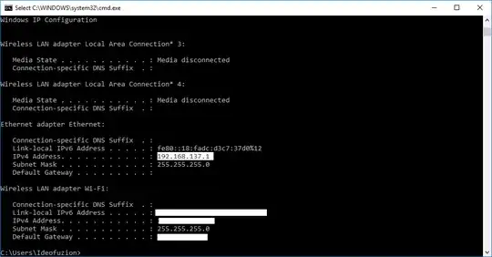

  1. Checked the IP of my network adapters by entering ipconfig command in the cmd.
This is the screenshot to show active networks:

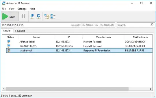

  1. Then I scanned all the IP Addresses of my Ethernet network use advanced IP scanner

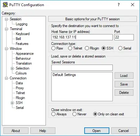

  1. Then I entered the IP address in the puTTY and clicked open

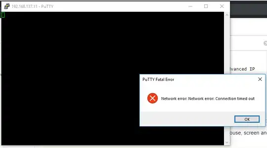

  1. After some time puTTY give an error Network error: Connection timed out.

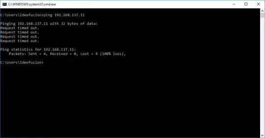

  2. After reading answer of this question, I ping the IP of my Raspberry PI in which I was shown error there.

You appear to be attempting to use Internet Connect Sharing (ICS) on Windows to connect the Pi.
This works - to give internet access to the Pi.
Unfortunately this can not be used to provide ssh or VNC access to the Pi. You can have EITHER ICS OR ssh - not BOTH.
If you want to use ssh you have to disable ICS.
You would be better to connect the Pi to your router.
