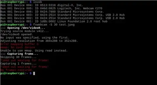

I am trying to make a usb webcam work on my rpi but it drives my nuts. I have Rpi 3 model B+ Also I've downloaded the newest raspbian image (stretch with desktop and recommended software). It's updated and upgraded. At first I installed fswebcam and it worked fine until I've installed uv4l for webrtc streaming. Now my webcam just doesn't work.
pi@raspberrypi:~ $ lsusb
Bus 001 Device 004: ID 0513:0318 digital-X, Inc.
Bus 001 Device 005: ID 046d:0825 Logitech, Inc. Webcam C270
Bus 001 Device 006: ID 0424:7800 Standard Microsystems Corp.
Bus 001 Device 003: ID 0424:2514 Standard Microsystems Corp. USB 2.0 Hub
Bus 001 Device 002: ID 0424:2514 Standard Microsystems Corp. USB 2.0 Hub
pi@raspberrypi:~ $ fswebcam -S 30 test.jpeg
--- Opening /dev/video0...
Trying source module v4l2...
/dev/video0 opened.
No input was specified, using the first.
Adjusting resolution from 384x288 to 352x288.
Error mapping buffer 0
mmap: No such device
Unable to use mmap. Using read instead.
--- Capturing frame...
Skipping 30 frames...
Timed out waiting for frame!
Capturing 1 frames...
No frames captured.

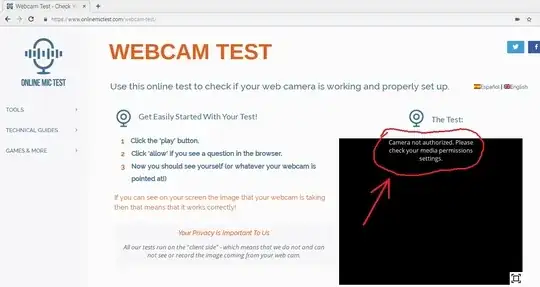

Now I can't test my webcam even with a browser.
Camera not authorized. Please check your media permissions settings.
How to repair webcam initialization?
