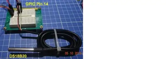

DS18B20 can be detected with the following configuration:
Raspbian stretch 2019apr08
Python 3.5.3
W1ThermSensor V0.3.0
DS18B20
Program and sample output
# DS18B20_test28 tlfong01 2019may10hkt2137 ***
# Raspbian stretch 2019apr08, Python 3.5.3
# W1ThermSensor V0.3.0
# dtoverlay=w1-gpio,gpiopin=14
from w1thermsensor import W1ThermSensor
def findSensor():
    for sensor in W1ThermSensor.get_available_sensors():
        print('  Sensor ID =', sensor.id)
    return
def getTemperature():
    sensor = W1ThermSensor()
    temperature_in_celsius = sensor.get_temperature()
    print('  Temperature in Celsius =', temperature_in_celsius)
    return
# *** Main Test ***
print('Begin Testing Ds18B20, ...')
findSensor()
getTemperature()
print('End   Testing DS18B20, ...')
Sample Output - tlfong01 2019may10hkt2150
 RESTART: /home/pi/Python Programs/Python_Programs/test1198/ds18b20_test27_2019may1001.py
  Sensor ID = 021312ca3baa
  Temperature in Celsius = 25.562
# *** End of program ***
