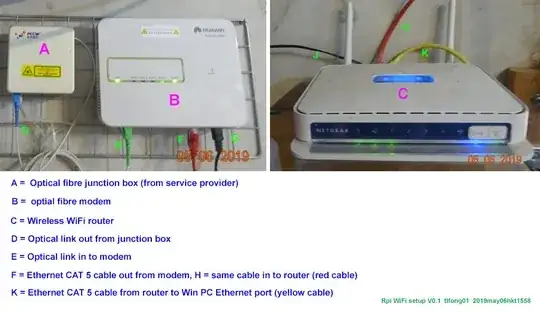

I guess you are now using a networked Win PC. My first suggestion is to forget wireless WiFi for now, instead use a wired Ethernet CAT 5 cable to connect from router Ethernet port to Rpi Ethernet port. In case you don't have a spare Ethernet cable, you can consider borrowing the router/PC cable (at your own risk!).
Now you have a wired connection, then you can sudo update/ugrade, or download a new Raspbian 2019April version and install it to your Rpi.
My home setup is displayed below. I usually use another Ethernet cable to connect the router to Rpi for a wired connection. But if you have a very different setup in office or at home, you might like to show us a picture to make sure.
home wifi setup

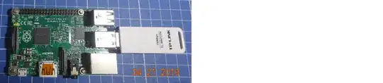

For Rpi2B models with built in WiFi
The suggestion above assumes you have Rpi3B+ with built in WiFi. If you have a Rpi2 without built in WiFi, then you need an external WiFi adapter/dongle and try the following steps.
  1. Download/install Raspbain image on a SD card inserted in Rpi3B+, or just use the current working SD card.
  2. Use the same SD card to boot your Rpi2, with the external WiFi adapter/dongle inserted in your Rpi2B.
rpi2b and dongle
raspbian download and setup

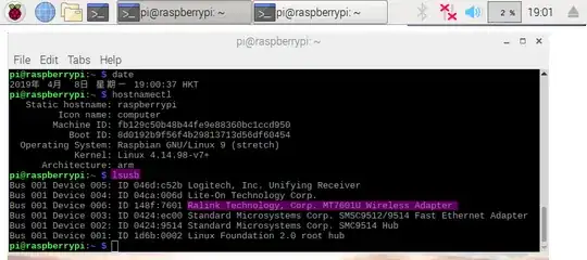

After booting up Rpi2B, you can use $sudo lsusb to see if your WiFi dongle has been detected.
rpi2b wifi dongle

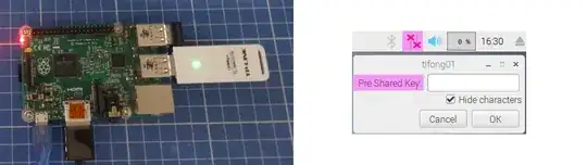

You can give your SSID and password now. You can do it in the desktop GUI, which is easier then using terminal commands, as illustrated below.
Entering Wifi SSID and password at desktop
setting up Wifi in desktop is even easier. The steps are listed below.
Select your Wifi country (otherwise top right network icon won't work).
At top right corner, click the double red cross icon (Wifi and Ethernet).
Select to turn on your network in the list (my network name is tlfong01).
Enter password (pre shared key).
rpi2b wifi setup
