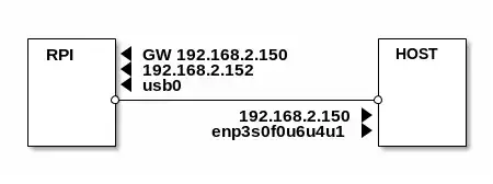

Script works correctly for the most part (usb interface is created, ip address and gateway assigned), but avahi does not see my raspberry when connected to the pc. My network setup looks like this:
Host pc interface:
enp3s0f0u6u4u1: flags=4163<UP,BROADCAST,RUNNING,MULTICAST>  mtu 1500
        inet 192.168.2.150  netmask 255.255.255.0  broadcast 192.168.2.255
        inet6 fe80::7dfe:77a0:ed21:f67c  prefixlen 64  scopeid 0x20<link>
        ether 48:6f:73:74:50:43  txqueuelen 1000  (Ethernet)
        RX packets 458  bytes 35426 (34.5 KiB)
        TX packets 85  bytes 18024 (17.6 KiB)
Raspberry pi interface:
usb0: flags=4099<UP,BROADCAST,MULTICAST>  mtu 1500
        inet 192.168.2.152  netmask 255.255.255.0  broadcast 192.168.2.255
        ether 42:61:64:55:53:42  txqueuelen 1000  (Ethernet)
        RX packets 0  bytes 0 (0.0 B)
        TX packets 0  bytes 0 (0.0 B)
Raspberry pi routing table:
Destination     Gateway         Genmask         Flags Metric Ref    Use Iface
0.0.0.0         192.168.2.150   0.0.0.0         UG    0      0        0 usb0
192.168.2.0     0.0.0.0         255.255.255.0   U     0      0        0 usb0
Tutorial checklist:
  • [X] Added setup script to rc.local
  • [X] Added required modules to /etc/modules
  • [X] Added dtoverlay=dwc2 to /boot/config.txt
Other info:
  • For raspberry I'm using 2019-04-08-raspbian-stretch-full
  • On desktop I'm using Gentoo Linux
  • No networking configuration other than in script were performed on the RPI
  • When using avahi-browse (I use avahi-browse -atr) I can see enp3s0f0u6u4u1.
  • Pinging RPI results in 100% packet loss but no errors.
  • I cannot ssh to the rpi (ssh pi@192.168.2.152) - it gives me error: ssh: connect to host 192.168.2.152 port 22: No route to host
  • Restarting interface on the host (sudo ifconfig enp3s0f0u6u4u1 down and sudo ifconfig enp3s0f0u6u4u1 up) didn't result in anything.
  • All logs files can be viewed here
  • I've already tried using g_ether - it works but does not fit my needs (I need to have Ethernet and usb hid at the same time `g_ether -- does not allow it).
  • I've omitted rpi-update from tutorial because it was necessary only for old kernel (pre-4.4)

I assume you are using a Raspberry Pi Zero.
I only had a glance at this tutorial, tldr; but it is more than 3 years old and seems to be complete outdated. With current Raspbian images you never need to fiddle with the kernel and scripts for config and gadget, serial- and ethernet adapter, keyboard/mouse and mass storage. There are some odd issues with the tutorial:
1) The tutorial is for Raspbian Jessie. It isn't usable for Raspbian Stretch.
2) The tutorial uses rpi-update. You should not use it without cause. Please read Do I still need rpi-update if I am using the latest version of Raspbian?.
3) The tutorial uses /etc/rc.local. Please take note that using /etc/rc.local has limitations due to Compatibility with SysV. We have seen many problems here on this site using it. Following the recommendation of the developers from systemd you should avoid using it.
So I suggest to start over again with Raspbian Stretch Lite. Then just configure two options and it should do. Add dtoverlay=dwc2 to /boot/config.txt and modules-load=dwc2,g_ether to /boot/cmdline.txt. You can look at HowToOTGFast how to do it and for details look at Raspberry Pi Zero OTG Mode. Because I don't have a Raspberry Pi Zero I can't test it but I'm quite sure it also works with Raspbian Stretch.
