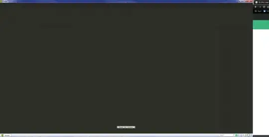

I am having an issue where I cannot view/edit the contents of a file that is larger than a few lines of text/code. When I use nano to open a file the system hangs after displaying: "[Read N lines]" and the only thing I can do is kill/restart the ssh session.
text editor output in cmder
I have tried multiple text editors (nano, vi, vim) and ssh clients (cmnder, putty) with the same result. I have also verified that the files are in unix format.
Is there a workaround to be able to read/edit larger files in the ssh session?
