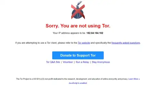

I connected my phone to the wireless access point and went to official tor site to checked if tor was working or not.
tor not working

You have to make the RasPi a Tor Proxy that will redirect all data to the Tor network. The good news is that the setup of a Tor proxy does not depend on the underlying network configuration. So you can use any stable network configuration to setup a Tor proxy on it.
Because you have already Setting up a Raspberry Pi as an access point - the easy way that's a good entry point for my suggestion. It doesn't fit exactly your needs because the example uses a WiFi repeater with a wireless uplink. But it should not be a big issue to adapt it to your needs with a wired uplink. You can look at How to make Raspberry Pi a Tor router with all kind of network setup using systemd-networkd.
In that tuturial is an example given to set /usr/local/etc/default/torproxy. Don't use that, instead set it to:
# interface to be used as entry point to the Tor network
TOR_IFNAME=wlan0
TOR_IFADDR=192.168.4.1
You wrote that your bridged access point is running. I assume your access point has the ip address 192.168.4.1. If not then change TOR_IFADDR= to that of your access point. Then go on with setting up the tor proxy.
