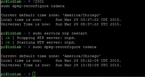

Sorry to drudge up an old question; however, I recently encountered a similar problem and the various answers here suggested that we need some clarification.
I was able to reproduce the OP's problem by disconnecting power to both my router and RPi, then starting the RPi prior to the router. Under these conditions, the NTP service did not have internet access and apparently relies on the hardware clock. tzdata was correct at the time of the problem.
Rebooting the RPi once the internet connection was restored solved the problem. If for some reason the RPi cannot or should not be shut down, one can restart the NTP service with sudo service ntp restart.
