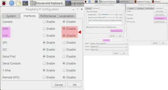

So now you don't VNC/SSH. Perhaps you should check the Desktop Rpi Config that VNC/SSH are disabled.
rpi setup
