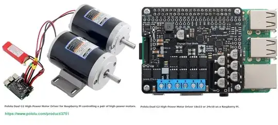

1) Can I run the motor using a High Power Motor Driver like the one in the link below? Will there be any other issues with it? https://www.pololu.com/product/3751

The Motor Driver
Rpi HAT 6.5~30V, 18A cont, 50A limiting, 100kHz PWM
The motor driver python library
Specification
Uses 6 GPIO pins 4 GPIO PWM, 2 GPIO input,
External current sensing through-holes
Locked-antiphase - low duty cycle one direction, high duty cycle other direction, 50% duty cycle motor off
Pololus Warning
This motor driver has no over-temperature shut-off. An over-temperature or over-current condition can cause permanent damage to the motor driver. You might consider using either the driver’s integrated current sense output (with an external ADC) or an external current sensor to monitor your current draw.
This product can get hot enough to burn under normal operating conditions. Take care when handling this product and other components connected to it.

If your motor steady current is 5A, then using the Polous 18A steady, 50A peak is of course an overkill. Perhaps you can search for a smaller driver.
