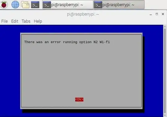

I am trying to turn on the network option in raspi-config, but when I do, I get this error:
could not communicate with wpa_supplicant
Then I hit enter to continue and I get this message
There was an error running option N2 Wi-Fi

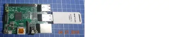

Setting up Rpi2B with a Wifi Dongle

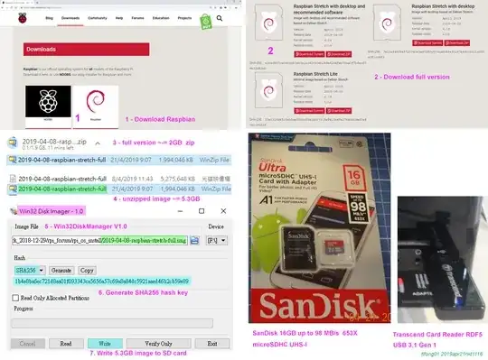

rpi2b and wifi dongle
Preparing a micro SD card with Raspbian stretch 2018apr image for Rpi2B and Wifi Dongle

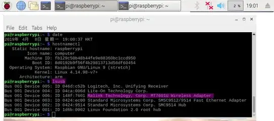

Checking out if Rpi2B Raspbian stretch 2019apr can detect TP-LINK TL-WN727N
I found the setup can detect the TP-LINK Wifi dongle. I remember I needed to google a list of dongles that Rpi can detect. So I would suggest you to check that out by the command lsusb. If you can detect the dongle, then you are almost there! :)
tplink wifi adapter

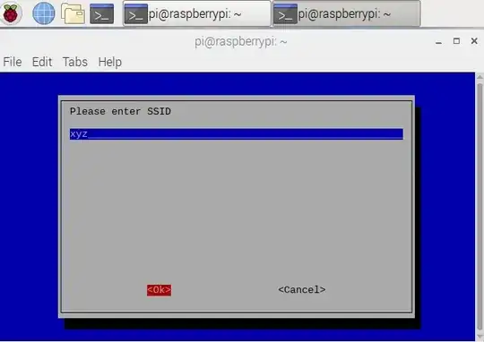

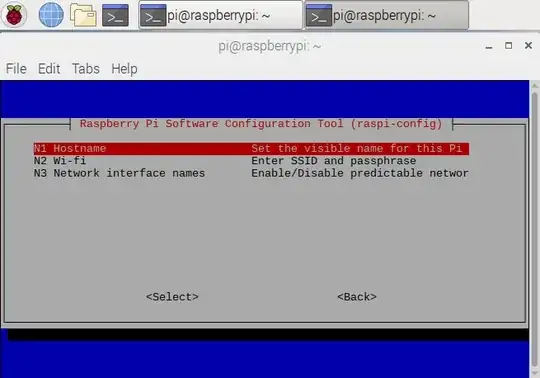

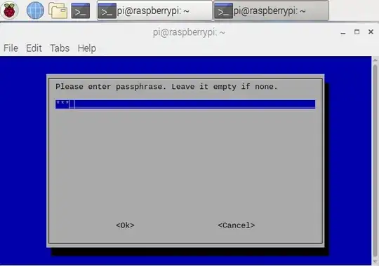

When you are configuring WiFi under terminal mode, you should have gone through the last couple of steps as shown below:
wifi config 1
wifi config 2
wifi config 3
wifi config 4
You must enter the correct ssid and passphrase, otherwise you will get the N2 Wi-fi error message.
The "ssid" and "passphrase" should be the same for your other WiFi devices, such as your mobile phone. You might like to try your ssid and passphrase with your mobile phone first, to make sure they are OK.

You are using a Raspberry Pi 2B. This model does not have an on-board WiFi device so it does not make sense to enable WiFi with raspi-config. It seems this results in the error message you reported.
