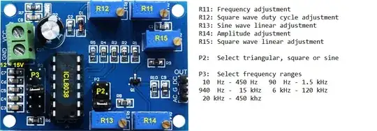

Have you considered the function generator modules? They are as small as 2.5cm x 5cm, so can piggybacked on to Rpi.
AliExpress AD9850 DDS Signal Generator Module 0-40MHz 2 Sine Wave and 2 Square Low-pass Filter Crystal Oscillator Test Equipment Board US $12.45
AliExpress ICL8038 Sig Gen Med/Low Freq 10Hz-450KHz Triangular/Rectangular/Sine Wave Generator Module 12V to 15V US$2.59

ICL8038 Precision Waveform Generator/Voltage Controlled Oscillator September 1998 File Number 2864.3
Everything You Always Wanted to Know About the ICL8038 Application Note November 199 AN013.1 Author: Bill O’Neil

8038 sig gen
