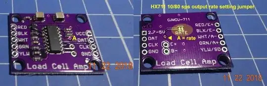

hx711 block diagram
hx711 rate setting jumper
