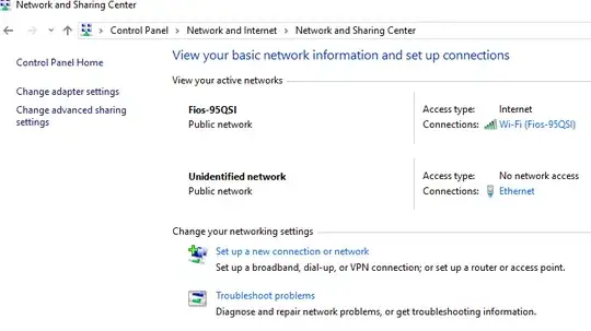

For sharing internet to multiple users over Ethernet, go to Network and Sharing Center. Then click on the WiFi network: Click on Properties (shown below), then go to Sharing and click on “Allow other network users to connect”.
How do I change Network Connection to Local Area Network? Is this even required in my case? This is where the confusion starts.

Here is how my network looks

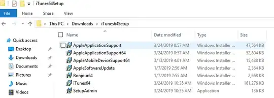

Downloaded iTunes. Unzipped with 7Zip. Installed Bonjour 3

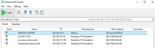

When I scan for IPs, I get this - I cannot ping any of these IP addresses

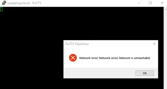

When I SSH (via Putty) to raspberrypi.local I get following error

If you connected the RasPi to the MS Windows 10 laptop by ethernet you should be able to ping raspberrypi.mshome.com from the laptop. It's also possible to install Bonjour for MS Windows (some infos see also https://raspberrypi.stackexchange.com/a/94629/79866). Then you should be able to ping raspberrypi.local.
Make sure that ssh is enabled on the RasPi. You can do it by putting an empty file named ssh into the /boot directory with:
rpi ~$ sudo touch /boot/ssh
Then reboot.
