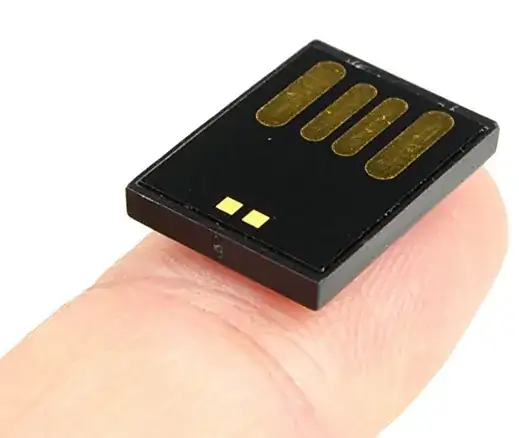

In the end, I am using tiny USB sticks, like this one
$9.90 for 32gB from Amazon USA (much cheaper from Ali Express)
I know that I wanted a solution that was not an SD card, which this effectively is.
But, it's small, cheap, separate from the SD card that holds the o/s. Plus, it is removable, indeed hot-swappable, while the Pi is running. That wasn't an original part of the question, but has shown itself to be a bonus.
