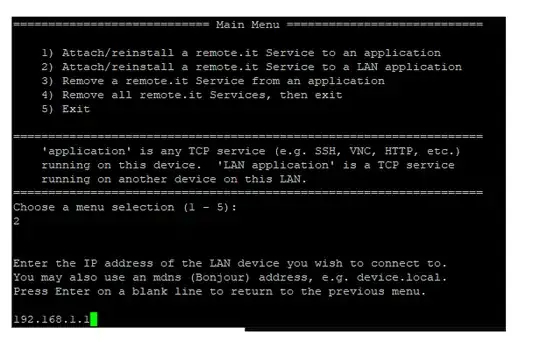

Ahh.. At last I connected to my LAN device from internet or from anywhere without router or by using pi and dongle only. steps are as followed :-
  1. Configure the USB modem.
remember to use :- pi# sudo wvdial instead of pi# wvdial otherwise it will give a error & also change APN to given by network operator. after all this your pi should have internet coming from usb modem.
  1. Give the respberry's eth0 a Compatible static I.P & subnet mask so that raspberry pi is able to connect to the sensor device
  2. Now install remote.it in raspberry pi & configure your personal account.
  3. Now the most trickiest part, Create a proxy connection to your raspberry pi which will attach required device's (sensor) TCP service to your internet(Its ) enter image description here

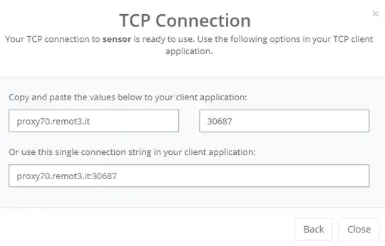

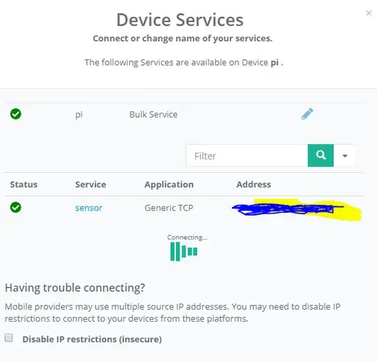

    5.Now login in your remote.it web portal from anywhere in world & get your proxy address with its port this proxy is between internet & the sensor device. enter image description here enter image description here
So now we are able to connect to any device of our tcp private network from any part of the world by using raspberry pi & dongle only. Here service provided by remote.it is groundbreaking its very innovating.

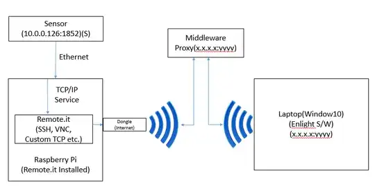

Update 1 :- system is some sort of as in below picture. enter image description here
