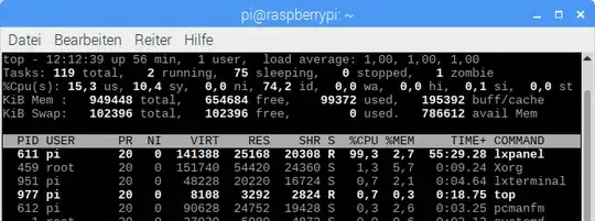

I opened a terminal and used top to have a look at the process list and CPU consumption. It tells me that lxpanel is at 100% CPU, which AFAIK matches the 25% of the graph, since my RPi3 has 4 cores and top uses 100% for one core, whereas the graph will be filled 25% only (100% of 400%).
Screenshot of top
As you can see in the screenshot, the load average is 1.00, which is likely due to lxpanel, since that has already 55 minutes of CPU time (of 56 minutes uptime) and at the time of the screenshot used 99.3% as well.
