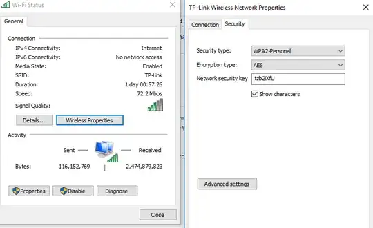

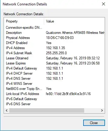

can't establish connection wia WIFI. Can't understant what I'm doing wrong:
there is connection properties from my windows PC enter image description here
