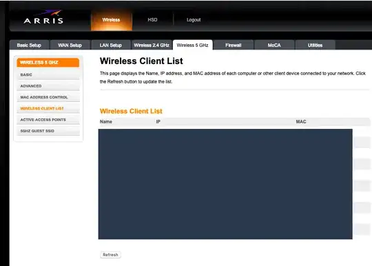

I would check to see if it's connecting to your wifi network. You can go to your router admin page and view a list of clients.
If the device is listed there then you could try connect using the listed IP as well as the host name raspberrypi.local

But likely it's not connecting to the network.
