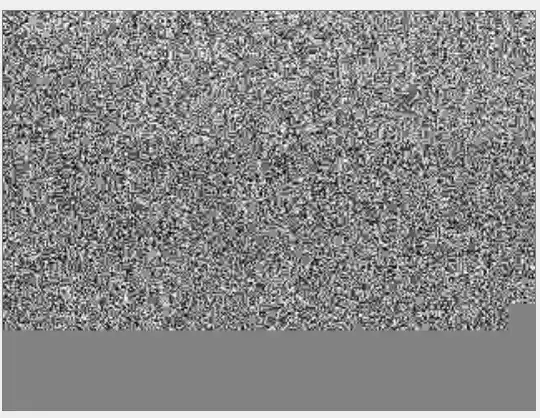

I figure, okay, chrome and firefox support h264, so does webrtc, and so does raspivid. When I try passing the stream directly to the webrtcbin it will send it to the browser but with a lot of stuttering or out right artifacts:
This trying to use the videotestsrc element converting it to h264 and sending it to the webrtcbin
