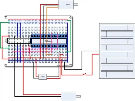

I have just started using a servo to drive the front steering of a remote control car frame which i cannibalised. The steering works fine if i start it up and tune it however when i shut down the raspberry pi and then turn it on again the servo goes full blast well out of the range i set up initially (or trys to) and then consequently i think this is causing the internals gears to slip etc because my angles which were set up nicely before are then all wrong again!
Is this something to do witht he raspberry pi's boot method? Is it possible to stop this from happening within the code or will i need to implement some hardware?
update wiring diagram (sorry its a bit messy its only the second i've ever made and i did it quickly) enter image description here

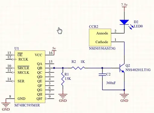

Pull Down resistor
Its only purpose is to keep the PIN low when its in the floating state (not initialised by Pi yet) So the Resistor is connected to PIN and GND. Then your device is connected to PIN as normal. So both Resistor and device are connected to the PIN. But only resistor to GND (So it pulls down the PIN on any stray voltage - And you activate it it will go to 3v3 and the resistor will no longer pull it down but your device will sense the change- This does not affect PWM) This pull down can be on your devices side too)
An easy to follow example.(Ignore the part numbers and pretend that is your Pi pin and the thing-a-ma-jig marked as CCR2 is your servo)
R1 is connected to PIN 1 to pull it down. Pin 1 is also connected to another resistor in series to limit the current for the transistors range. A transistor is a simple gate. If powered on the BASE the gate "connects" COLLECTOR and EMITTER and lets the current flow in the direction of the arrow. In this diagram its a NPN transistor most likely something like a 2N2222 (cheap and cheerful). This is also a very nice way to "BUFFER" your circuits. As you can notice the 7volt supply lights the cathode bulb and goes to GND, without ever reaching your Pi/MCU. The capacitor is not required but it seems to be used here to smooth out (debounce) the switching process) The LED is just coolness.
So your GPIO pins do not drive any heavy loads directly- Doing that can burn out the CHIP or PCB tracks. Instead you supply a voltage with more amps and better copper that will give that burst of energy, while your digital circuit (GPIO and Transistor) control the flow while being protected.
Remember to check if the transistor can handle the load. In most cases if overloaded the transistor will burn out before damaging your digital device.

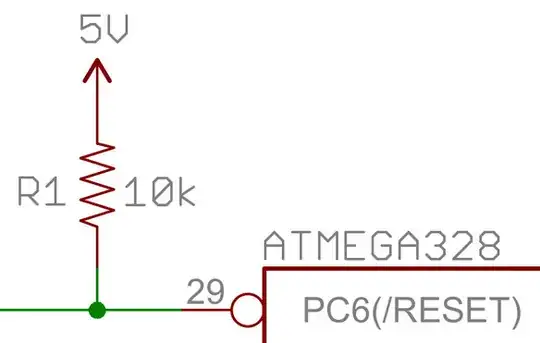

Pull Up resistor
This resistor is connected to V+ instead of GND and pull the PIN high while floating. This type is not common and only required for specific purposes.
As demonstrated on the Arduino Atmega328. The RESET pin must always be pulled up so that the internal circuit knows it is operating normally. If this pull up drops to the point where the internal circuit thinks its changed from HIGH to LOW (because of battery going flat) that is known as a brown out- and the 328 will reset and behave erratically.
So in this case it is imperative that the RESET pin is always HIGH to indicate normal behaviour.
