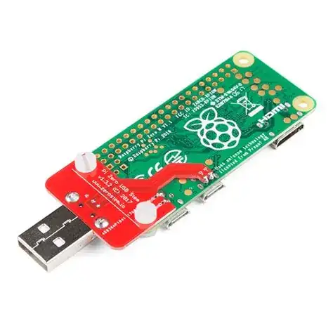

For the hardware, you probably want something like this, called the Pi Stem. enter image description here
