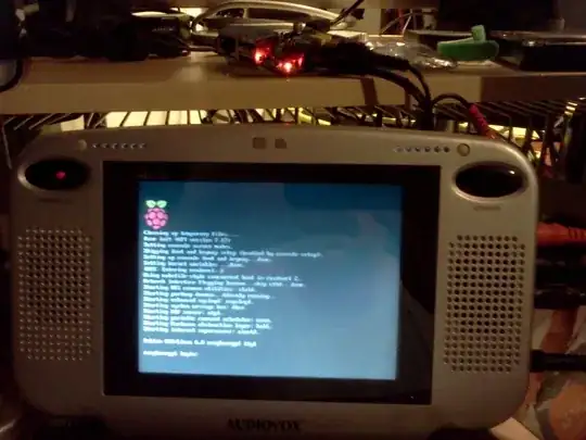

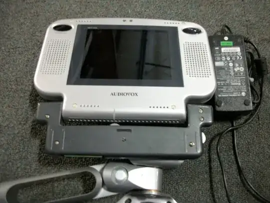

If price didn't matter to me, I probably would have purchased one of the Lilliput monitors, but price does matter to me, so I didn't. I ended up deciding on a DVD "second screen" that had an included mount and AC adapter on eBay. second screen Sound inputs are included, and it has AC power. I don't plan on my usage requiring anything too fancy in the resolution department, and I was looking for the most cost-effective way to get my Raspberry Pi running. Getting it from ebay meant that I paid a pittance ($20), but I had to lurk around a lot of different auctions to find it at that price, since they're usually closer to $50. This also means that I don't have a warranty and I'm purchasing a product more or less sight unseen, so I may not have the image quality that I was originally hoping for. In my case, it worked fine when I hooked it up, as evidenced below: running the Pi
