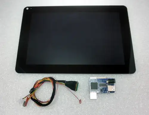

This is the largest touch screen that I could find for the Raspberry Pi (10"):
Info from the website:
This plug-and-play bundle includes:
  • 10" glossy screen LCD with IPS technology, 1280x800 px, 256K (18-bits) colors with integrated multi-points capacitive touchscreen with USB interface (USB cable for touchscreen is included)
  • new HDMI-LVDS converter board that has all required voltages for LCD, can power RaspberryPi through USB connector, contains PIC controller that can be programmed to provide EDID information (like screen resolution, etc) over DDC/I2C interface and also can control LCD brightness in automatic (with help of ambient light sensor) or manual mode
  • LVDS cable
  • ambient light sensor (can be connected as a part of LVDS cable to HDMI-LVDS converter) for automatic LCD brightness control
Can be connected to virtually any HDMI source that can provide native LCD resolution.
Additionally you can order power adapter to power whole system (RaspberryPi + HDMI-LVDS converter + LCD) and short USB-microUSB cable (7.5cm/3") to power RasPi right from HDMI converter.
Here is a video of it in action.
